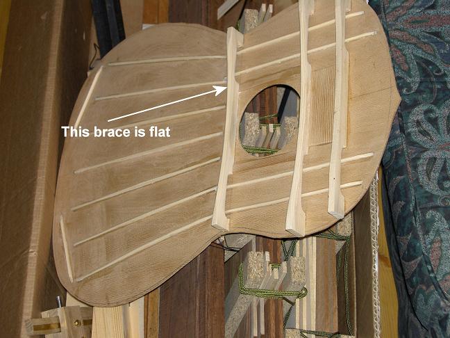

I am just starting classic build No.3 and I have glued the lower harmonic brace onto the sound board without any radius. The fan braces are holding the lower bout to the correct radius.
The question is, do cut off the lower harmonic brace and start the brace again or live with a missing radius that might not be too noticeable if at all?
I am not under any time constraints but it seems a lot of effort for a little gain
What do you people think?

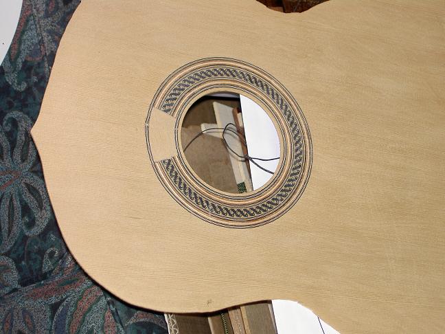

I have included a picture of the brace in question and I also included a picture of my first homemade rosette

I know nothing about your dilemma but until the experts chime in here's a thought:
If you have made 2 other classicals with the brace radiused, you could complete this as is and compare this to the other 2 as far as structural strength over time as well as any tonal differences.
Then again...the classical experts will probably have a better idea.

I am by no means an expert but most classical plans I have seen only the fan braces were arched and everything forward of the fan braces were flat.
PostPosted: Tue Sep 04, 2007 12:57 am
I think Michael is right.  All Bars are flat.  No radius beyond the fan bracing.  Flat is what the Romanillos plans call for.

I make mine flat.

and i arch mine...
but think its a matter of self preference, and doubt there's much reasoning to it.

The reasoning to the flat upper section would be neck and FB fit-up as Historically Spanish heel necks were in a flat plane relationship to the body as apposed to a Steel sting with a 1.5 deg back angle. If you dome the whole body then you have a bit of fit up issue to deal with on the FB.

My lower harmonic bars are radiused.

Michael, we're talking about the lower harmonic bar here, which is in the waist area as opposed to the upper bout. I agree with Udi that its just preference.
Also Classical guitars are not necessarily built on a flat plane, with no angle.

I've made the lower bar both ways, flat or slightly arched. There is no advantage to arching the ones above the soundhole, it would only exaggerate the difficulty of fitting the fretboard given the 2mm or so lift at the nut as it passes onto the top.
Hauser seemed to have built his flat, the Romanillos solera has a slight arch in this portion onto which a flat brace is fastened.....usually this results in an assembly that has around half of the arch of the solera.
I think the thing to pay attention to here is not the arch of the brace, but its overall stiffness and mass.

Oh I did not say all. I said the plans that I had dealt with, mainly Hasser Sr. 1946 and Jose Rameriz 1966. neither of them had a back angle on the neck.
My point was that Ricallo would be fine with the flat braces past the fans.
The fretboard fit-up issue I mentioned was not meant to state it is wrong to do so just that the construction must take the upper bout dome into consideration. geez I feel like I have been spanked.

Just to add to this -- I leave my upper bar flat and radius the lower bar. But if the lower one is flat as well, I don't think it will matter that much.

Ricallo - don't do anything. Leave it as is. We all do these things our own way and as this thread seems to prove it doens't make much of a difference one way or the other. Certainly no reason to redo previous work.
